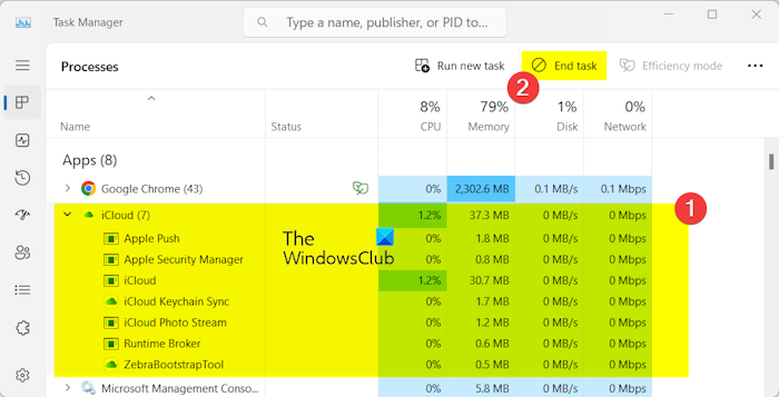

First, exit the iCloud app and then go to your system tray.
The app must be running in the background; open the Task Manager using CTRL+SHIFT+ESC, select the iCloud app from the Processes tab, and press the End task button.

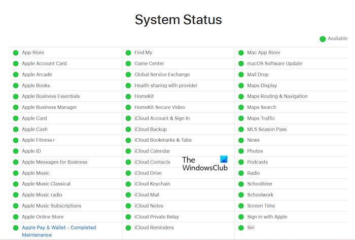

3] Check the iCloud service status
If iCloud services are currently down, you will likely experience sync errors and problems with iCloud Drive on Windows. Hence, rule out the possibility of any ongoing server issues at the end of Apple. You can open the Apple’s System Status page and check whether iCloud Drive services are running.

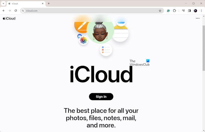

9] Use iCloud on the web
The next thing you can do to sync your iCloud files and folder on Windows is to use iCloud’s web version. You can open the icloud.com website in a web browser and press the Sign In button. After that, enter your Apple ID and password to sign into your account. Check if your data synchronizes correctly or not.

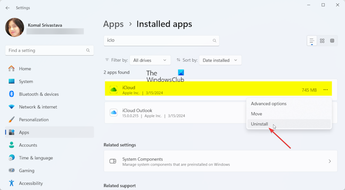

If the issue is still unresolved, you might be dealing with an incorrect or faulty installation of the iCloud app. You can uninstall the app and then reinstall it to fix the issue.
- First, quit the iCloud app and related processes completely using the Task Manager.
- Now, press Win+I to open the Settings app and go to the Apps tab. Then, click on the Installed apps option.
- Next, click on the three-dot menu button next to the iCloud app and choose the Uninstall option.
- When the app is uninstalled, delete any leftover files related to iCloud on Windows.
- Once done, restart your computer and open the Microsft Store to reinstall the iCloud app.
