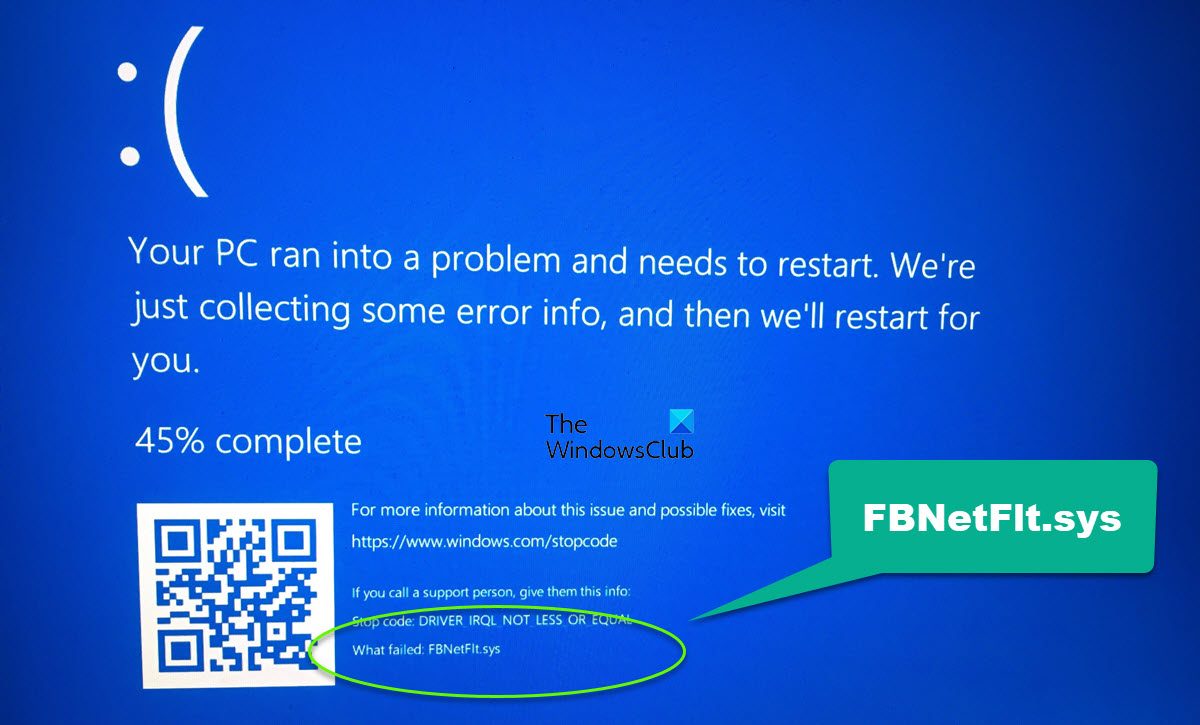

BSOD, or Blue Screen of Death, has always been a matter of grave concern for Windows users. A lot of those users encountered another BSOD. This time, it is caused because a file called FBNetFit.sys. FBNetFit.sys is a digitally signed driver file from Lenovo installed by the Lenovo Vantage app. If the driver file fails to load or run on your system, it causes a Blue Screen.
Your PC ran into a problem and needs to restart. We’re just collecting some error info, and then we’ll restart for you.
Stop code: DRIVER IRQL NOT LESS OR EQUAL, What failed: FBNetFit.sys
Fix FBNetFlt.sys Blue Screen on Windows 11/10
To fix the FBNetFlt.sys failed Blue Screen of Death on Windows 11/10, execute the mentioned solutions.

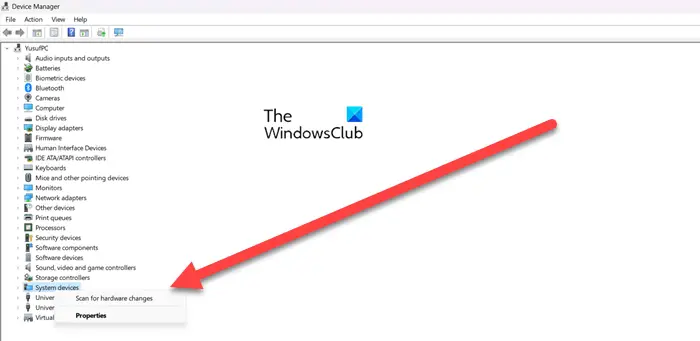

3] Reinstall Lenovo Gaming NetFilter Device Driver
As mentioned earlier, the issue is exhaustive to Lenovo devices and the Lenovo Vantage is the one causing the problem. Now, if you don’t want to remove the Lenovo Vantage app, or if removing the app doesn’t work for you, remove the Lenovo Gaming NetFilter driver from Device Manager and then add it again. In case the driver is corrupted, and is causing BSOD, then reinstalling the driver is the way to go.
- Open Device Manager by searching it out from the Start Menu.
- Expand System Devices.
- Look for Lenovo Gaming NetFilter Device.
- Right-click on the same and select Uninstall device,
- Click Uninstall again to confirm.
- Restart your device and see if the driver is reinstalled, in case, it isn’t reinstalled, right-click on System Devices and select Scan for hardware changes.
Once you have reinstalled the corrupted driver, reboot your system and see if the issue is resolved. Hopefully, this will do the job for you.
