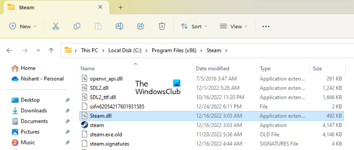

3] Copy the Steam.dll file to your game folder
It is clear from the “Failed to find Steam” error message that the game is not able to find Steam on your system. Such types of problems can be fixed by copying the Steam.dll file to the game folder. To do so, go to the following location in your system:
C:\Program Files (x86)\Steam
The above path is the default install location of Steam. If you have installed Steam on another location, you have to go to that path. The easiest way is to right-click on the Steam desktop shortcut and select Open file location.
Now, locate the Steam.dll file and copy it, and paste it into your game folder. You will find all your game folders inside the Steamapps folder.

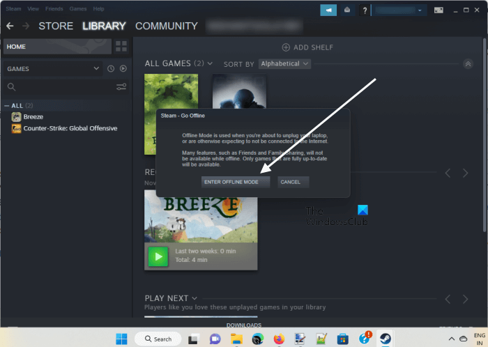

5] Go offline and restart Steam in online mode
This trick has worked for some users. Go offline in Steam and restart it in online mode. The following steps will guide you on this:
- Open Steam.
- Go to “Steam > Go Offline.”
- Click ENTER OFFLINE MODE in the confirmation window.
- Exit Steam and close it completely.
- Open Steam again. This time, Steam will ask you to go online or start it in offline mode. Select GO ONLINE.
Now, launch the game and see if it displays the same error message this time or not.
