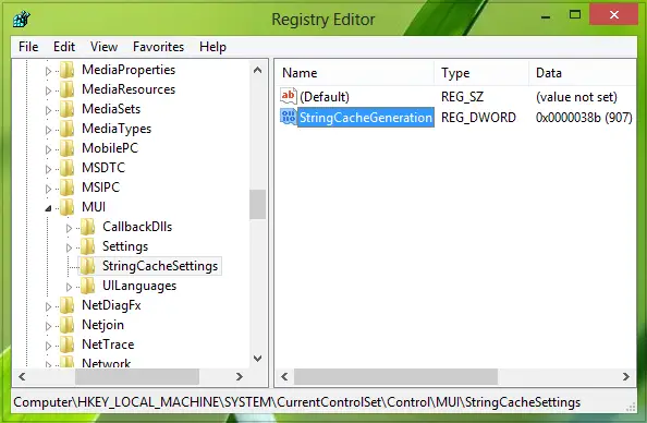

HKEY_LOCAL_MACHINE\SYSTEM\CurrentControlSet\Control\MUI
3. Now right click on the MUI key and select New -> Key. Name the newly created key as StringCacheSettings.

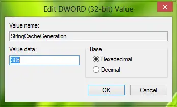

In the right pane of this newly created key, create a new DWORD value, name it as StringCacheGeneration. Double click this newly created DWORD to modify its Value data:
4. In the above-shown box, type the Value data as 38b. Make sure you have selected Hexadecimal base here. Click OK. You may now close the Registry Editor and reboot to get it fixed up.
