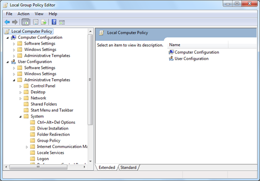

First, open the Start menu and type gpedit.msc. Press Enter. This will open the Group Policy Editor.
Now navigate to User Configuration > Administrative Templates > System.
Click on it, and in the right pane, you will be able to see Ctrl+Alt+Del Options as shown below. Double click that.

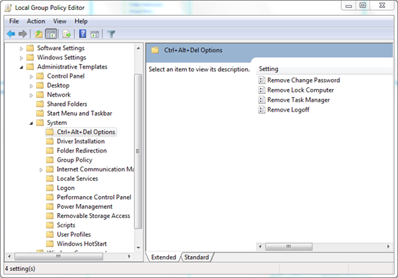

Now you will see the available options that you can customize in the right pane.

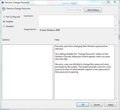

- Remove Change password: If you enable this, the Ctrl+Alt+Del screen will not show the Change Password option.
- Remove Lock Computer: If you enable this, you will not be able to lock the computer from the Ctrl+Alt+Del screen.
- Remove Task Manager: If you enable this, it will remove the Start Task Manager option from the Ctrl+Alt+Del screen.
- Remove Log Off: This option will remove the Log Off option from the Ctrl+Alt+Del screen.
Just double-click the setting that you want to change. Select Enabled or Disabled as you wish and click OK.
You can see the changes immediately by pressing Ctrl+Alt+Del.

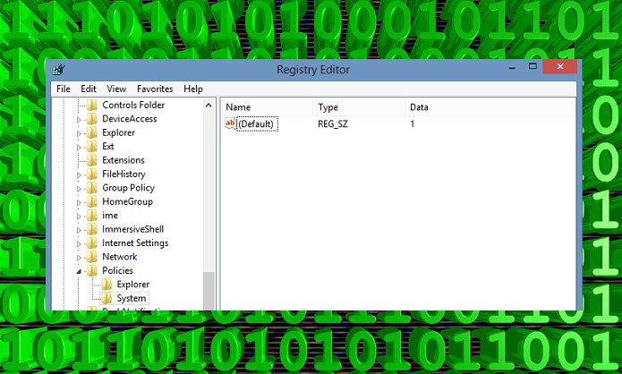

Should you wish to, you can opt to hide one or more of these options, as follows. Open Regedit and navigate to the following key-
HKEY_CURRENT_USER\Software\Microsoft\Windows\CurrentVersion\Policies\System

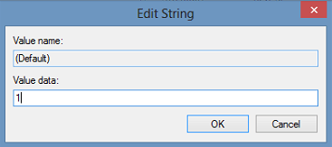

Double click on value/s mentioned below & set its value as 1. This will disable the corresponding option from appearing.
- DisableLockWorkstation
- HideFastUserSwitching
- NoLogoff
- DisableChangePassword
- DisableTaskMgr
If any of them don’t exist, right-click on any blank white space on the right side and create a New DWORD value name, as mentioned above, and set its value to 1.
This will disable the corresponding option. To revert to the default, you may switch the value back to 0.
