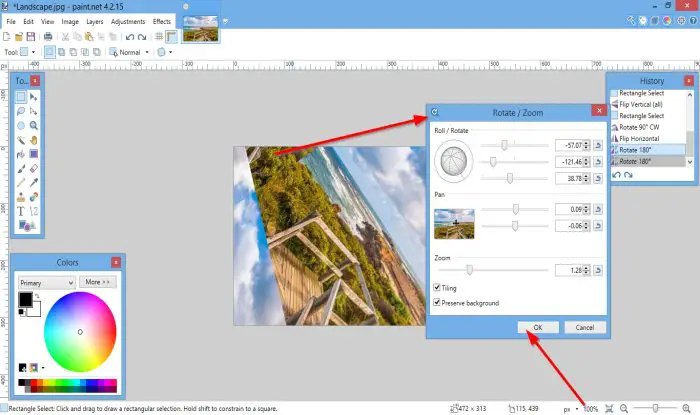

You can also click Layers on the menu bar.
You will see the different ways you can rotate the image in the drop-down list, such as Horizontal, Vertical, and Rotation One Hundred and Eighty Degree.
You can choose to select Rotate and Zoom.
A Rotate and Zoom dialog box will open.
In the Rotate and Zoom dialog box, where you see Roll or Rotate if you use the slider on the slide bar, the canvas’s image will change orientation.
Pan displays the image on the canvas. If you click on drag the image, the image will move on the canvas.
You can also use the Zoom slider to zoom the image.
You can check the checkboxes for Tiling and Preserve Background.
Then Press OK.
