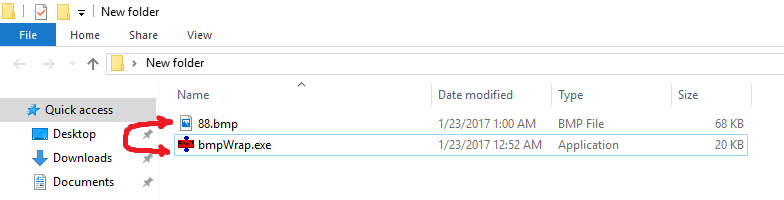

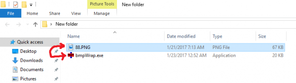

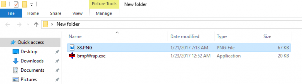

- Let us assume the BMP Wrap application which is a .exe file and the file to be converted are in the same folder.
- We drag the target file on BMP Wrap’s icon.

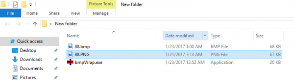

- The BMP image file would be created with .bmp extension.
- The BMP image file can be mailed to the intended recipient and converted to the original file by dragging on BMP Wrap. A BMP conversion software could be used at the receiver’s end as well.
- After doing so, the recipient gets the original file in the original format.
