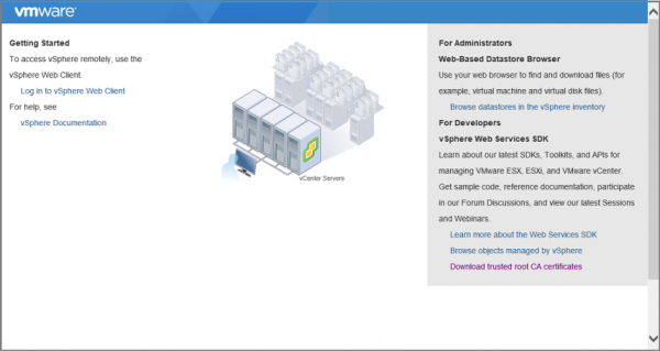

In the browser on Azure Backup Server, enter the URL to the vSphere Web Client. Instantly, the vSphere Web Client login page should appear before you. At the bottom of the description provided on the right-hand side, you can find the link to download trusted root CA certificates.
Hit the link to force vCenter Server to downloads a file to your local computer. For user’s convenience, the file is named as ‘Download’.

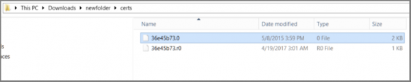

When done, right-click download.zip, and select ‘Extract All’ option to extract the contents. Once the action is complete, all the contents will be added to a folder named certs. Two types of files will be visible under the certs folder. (Note: The root certificate file has an extension that begins with a numbered sequence like .0 and .1. The CRL file has an extension that begins with a sequence like .r0 or .r1. The CRL file is associated with a certificate.)
Right-click the root certificate file in the certs folder, then click Rename. Change the root certificate’s extension to .crt. When you do so, the icon for the file will change to an icon representing a root certificate.

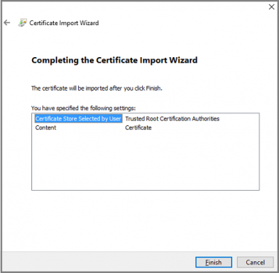

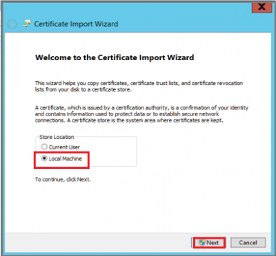

Right-click the root certificate and, from the pop-up menu, select Install Certificate. The Certificate Import Wizard dialog box will then appear. When it appears, select Local Machine as the destination for the certificate and hit the Next button to continue.
Next, on the Certificate Store page, select the ‘Place all certificates in the following store’ option and click Browse to choose the certificate store.
Choose ‘Trusted Root Certification Authorities’ as the certificate’s destination folder, and then click OK as seen in the picture below.
Before exiting the ‘Completing the Certificate Import Wizard page’, make sure that the certificate is in the desired folder. When verified and all appears fine, click Finish.
A dialog box should appear on your computer screen confirming the successful completion of certificate import. Sign in to the vCenter Server to confirm that your connection is secure.

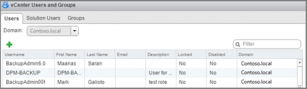

The above step marks the end of the second step. The third step is to create a vCenter Server user account and permissions. For this, access vCenter Server Navigator panel and find ‘Users and Groups’ section under it. Select it, to display ‘vCenter Users and Groups’ panel.
From it, choose the first tab ‘Users’, and then click the add users icon (the + symbol).
The action when confirmed will display ‘New User’ dialog box. Under it, add the user’s information and then click OK. The new user account will appear in the list.

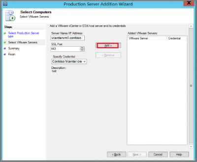

Next, associate the user account with the role and proceed to complete the last step of the process which includes adding the vCenter Server to Azure Backup Server. To complete this, use Production Server Addition Wizard. It helps in adding the vCenter Server to Azure Backup Server.
Use the Azure Backup Server console to access Production Server Addition Wizard.
Under it, select the ‘Production server type’ as shown in the image and choose the ‘Add’ tab to add the VMware server to the list of Added VMware Servers.
Finally, move to the ‘Summary page’ and add a specified VMware server to Azure Backup Server. The new server gets added immediately. Click Next to move to the next page in the wizard. This marks the end step of the process with the Finish page showing you the results.
