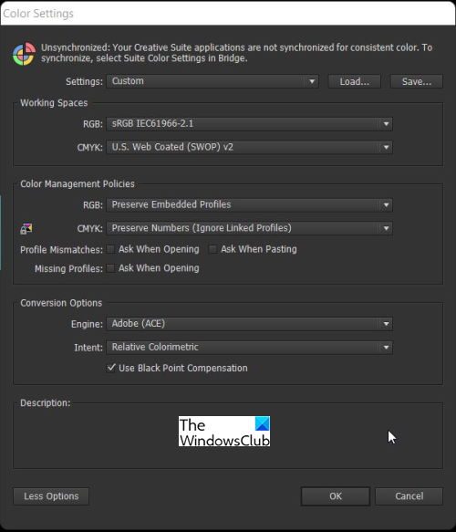

3] Overlooking Warnings
Adobe Illustrator will match all the options you choose to make sure they are compatible and will give a warning if there are conflicts. When you go into Illustrator’s Color Settings, you can choose to turn off the warnings by unchecking the three tick boxes which are to be warnings for Profile Mismatch and Missing Profiles. You can choose which to keep and which to turn off. These warnings can be set to Ask When Pasting and, Ask When Opening. When the Warnings are checked, you will be given a warning if there are any changes.
Overlooking the warnings or unchecking them can cause there to be conflicts in Illustrator, which can result in Illustrator changing colors. The warnings will not stop you from designing but when you save it may change and look different from what you had in mind. This can be frustrating, especially in cases where you or a client has already accepted the colors.
As you will note, when you see the color choices on the color palette, there may be a warning but it will allow you to still use the color in your artwork. Out of Gamut Warning means that the color is not available, it is out of the range. If you click the error icon, it moves the color picker to the closest color, which may be darker than the color that triggered the error. You will need to make the changes that the error message suggested or your project’s color will change.
The Out of Web Color Warning is mostly for those who are designing for the web, This warning means that the color will not be able to be produced. If this color is used, it may be changed by Illustrator for the closest color.
Note warnings and adjust the document options so Illustrator won’t change your color.
