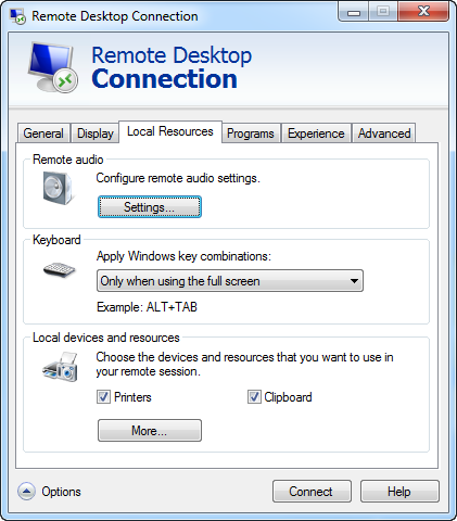

  • Click on Start then search for Remote Desktop Connections.
  • Click Options, and then click the Local Resources tab.
19 Oct 10 12 57 56 PM How to use Devices and Resources in a Remote Desktop Session

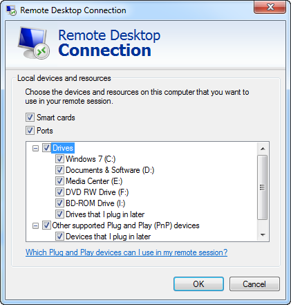

  • Under Local devices and resources, select the devices or resources you want to redirect.
  • To see additional devices, or to redirect Plug and Play devices or drives and devices that you plug in later, click More.
  • To redirect supported Plug and Play devices, under Local devices and resources, double-click Other supported Plug and Play (PnP) devices. The Plug and Play devices that support redirection and are currently plugged in appear in this list.
  • To redirect supported USB devices, under Local devices and resources, double-click Other supported RemoteFX USB devices. The USB devices that support redirection and are currently plugged in appear in this list.
  • Select the check box next to each device that you want to redirect.
19 Oct 10 12 59 57 PM How to use Devices and Resources in a Remote Desktop Session
To automatically redirect drives or devices that you plug in or connect to in the future, under Local devices and resources, double-click Drives, and then click Drives that I plug in later.  Or else, double-click Other supported Plug and Play (PnP) devices, and then click Devices that I plug in later.
