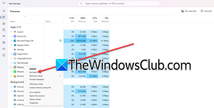

Before exploring time-consuming solutions, we recommend performing basic troubleshooting steps such as restarting VMware and rebooting the PC. These actions help resolve temporary glitches, such as hung processes or incomplete shutdowns. To begin, close the VMware Workstation, click Ctrl+ Shift + Esc to launch Task Manager, and ensure no VMware-related processes are running in the background.
Next, we will perform a system reboot to eliminate memory caches and terminate lingering processes. This will provide a clean slate for VMware to function. After rebooting, relaunch VMware and the Virtual machine and check whether the issue is resolved.

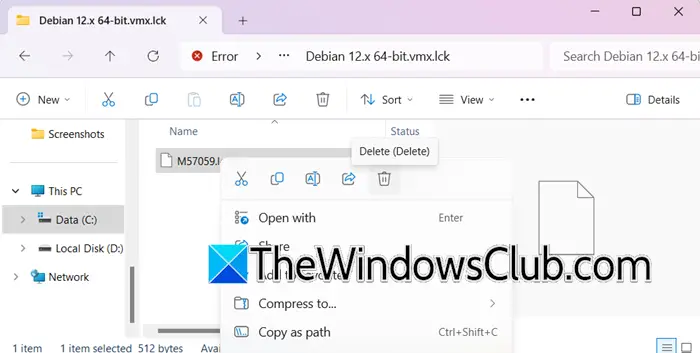

2] Delete Lock files in the VM directory
Lock files are used by VMware to prevent simultaneous access to the VM files; however, they are prone to corruption and can cause issues like the one we are facing. Moreover, after a crash or an improper shutdown, leftover or orphaned lock files can prevent the VM from opening. Fortunately, this issue can be resolved by deleting the files.
Follow the steps mentioned below to do the same:
- First and foremost, power off the VM, and close the VMware Workstation.

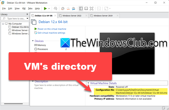

- Navigate to the folder where VMware files are stored, and look up all the folders that end with .lck. Make sure to backup the files in case you need to reverse the changes. To know the directory, in VMware Workstation, click on the VM, and check the Configuration file field.
- Right-click on each of them and delete it.
Once done, launch the VM, and check the status.

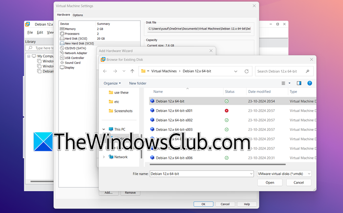

3] Recreate Virtual Machine
The root cause of the issue is that the Virtual Machine files are locked, and it occurs due to unexpected shutdowns, leftover lock files, or simultaneous attempts to access the VM from multiple sessions. In this case, we will recreate the Virtual Machine to refresh the VM’s configuration, and here’s how to do it.
- Launch the VMware Sphere Client, navigate to the inventory where the Virtual machine is situated, right-click on it, and select Remove.
- In VMware Workstation, click on File > New Virtual Machine.
- Next, create a virtual machine normally for the kind of operating system you will be using.
- After creating the virtual machine, right-click on it, and select Settings.
- Now, go to Hard Disk, and click on Add > Next.
- You will have to choose a few options, it’s better to keep them default; when you are on the screen where you are asked to select the hard disk, select Use an existing virtual disk, and click on Next.
- Click on Browse, navigate to the location where your original VM was stored, and select its vmdk file.
- Once done, click on Finish and then start the virtual machine.
Verify if the issue is resolved. If not, move on to the next solution.

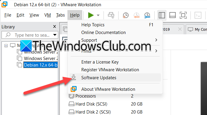

4] Check for VMware update
Updates often include enhanced error-handling mechanisms, and if the issue is due to software glitches or compatibility issues, updating VMware to the latest version might be able to resolve it. To begin with,
- Launch VMware, and click Help from the top menu bar.
- Click on the Software Update button, and wait for a while, VMware will automatically search for the latest available updates.
- Click on the Download and Install button. After the process is completed, follow the on-screen instructions to install the updates.
If you have installed an update, check if the issue persists.
