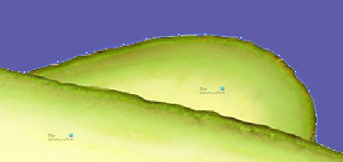

Use the Pen Tool to outline the image on the foreground. To use the Pen Tool, click on a point then move and click another point to create a connection. Make sure that the connection is closed at where you started out.
To make sharp corners or sharp turns click and drag to create handles so you can adjust to go around the sharp corners or sharp turns. These handles are also useful for making fewer connections by going longer and then using the handles to adjust to fit the curves. Don’t worry if the connections and curves are not perfect, you can adjust them by adding new Anchor points, removing anchor points, or even using the Pencil Tool or Smooth Pencil Tool to get them how you want them.
This is the image surrounded by the points of the pen tool. They look close because I was zoomed in so that I could catch all the details with the Pen Tool, and now it is zoomed out so I can take the screenshot.
