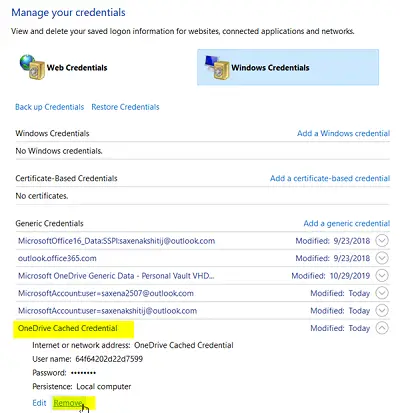

1] Open Credentials Manager
Click Start, type ‘credentials’ in the Search box and then select ‘Credentials Manager’ when seen in the list of options.
Next, switch to ‘Windows Credentials’ tab.
Read: How to fix OneDrive sync issues?
2] Remove OneDrive Cached Credentials
When the ‘Windows Credentials’ menu expands, go to ‘Generic Credentials’.
Here, look for any entries containing ‘OneDrive Cached Credentials’.
Hit the drop-down arrow adjacent to this option and choose the ‘Remove’ option to remove it.
When done, restart OneDrive and check if the problem persists.
Please note that you won’t lose files or data by disabling or uninstalling OneDrive on your computer. You can always access your files by signing in to OneDrive.com.
If this workaround doesn’t resolve the issue or fails to yield the desired result, kindly uninstall and reinstall OneDrive.
