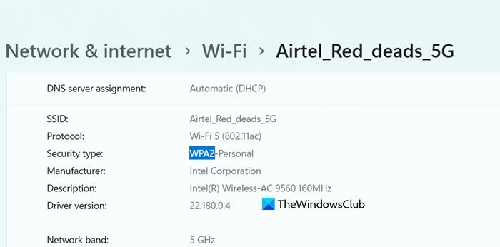

2] Reconnect or change your network
If you are using a MobaXtram to connect to your work computer, it might require a much more stable and secure network. If your current WiFi uses an older security protocol, MobaXtram might refuse to connect to the jump or host server, as that can provide a gateway to hackers. Hence, always choose WPA2 connections over WPA. However, if your router uses WPA2, we recommend refreshing by disconnecting and reconnecting to the WiFi. Once done, check if the issue is resolved.

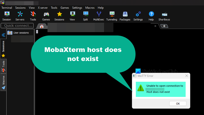

3] Connect to the VPN provided by your organization
You may see an error “Host does not exist” if you are not connected to the VPN provided by your organization. Mostly, there will be a shortcut to connect to the VPN in the taskbar, but if you can’t find it, contact your IT admin or folks handling the network and ask them about it.

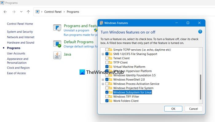

4] Make sure that Windows Subsystem for Linux is enabled
Next, we need to check if WSL is enabled on the client’s computer. Windows Subsystem for Linux allows you to run any SSH client, whether it’s PuTTy or, in this case, MobaXtram. To enable the feature, we need to follow the steps mentioned below.
- Open the Control Panel.
- Go to Programs.
- Click on Programs and Features.
- Look for Turn Windows features on or off and click on it. If you are connected to a work device, you will be asked to enter admin credentials that you can get from your IT admin.
- Scroll down and search for Windows Subsystem for Linux and tick the checkbox associated with it.
- Finally, click on OK.
After enabling WSL, reboot the computer and check if the issue is resolved.

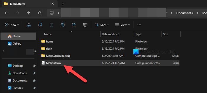

5] Delete the configuration file
If you are unable to launch MobaXtram local terminal, you should delete the configuration file that could have been corrupted and caused issues. However, we are not going to delete the file. Instead, we can rename it so that MobaXtram fails to detect it, but it will be there as a backup if required in the future.
To do the same, follow the steps mentioned below.
- Open File Explorer.
- Navigate to C:\Users\Your_Username\Documents\MobaXterm.
- Look for the MobaXterm configuration file or MobaXterm.ini file and then rename it to any name of your choice.
- After renaming the file, reboot your computer.
Now, launch MobaXterm. It will create a fresh configuration file since it can’t find the one that we renamed, and hopefully, it will not be corrupted.
Note: The location mentioned earlier is the default location, if you changed the home directory during the installation process, go to that location.

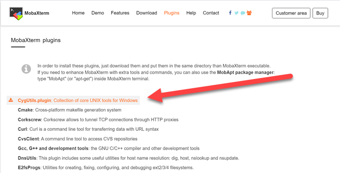

6] Download CygUtils Plugin
The CygUtils.plugin is a collection of Unix tools for Windows. Since you are trying to access MobaXtram Local Terminal, you need to have it on your computer. You can download the CygUtils.plugin from mobaxterm.mobatek.net/plugins.html.
Once downloaded, locate it in the same directory MobaXterm exe file. Then set your MobaXterm home directory (and possibly root directory) to Windows folders to which you have “Modify” access. You can do this in MobaXterm by navigating to Settings > Configuration > General and adjusting the “Persistent home directory” and “Persistent root (/) directory” to the folders of your choice.
