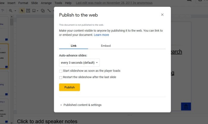

5] Publish a Google Slides presentation with loop
Yes, it is possible for users to publish their Google Slides presentation with a loop. The best way to do this is to click on File > Publish to the web. After this is done, you will have a few options to change. We suggest clicking on Link, then select the dropdown box to set the timing.
From there, choose Restart the slideshow after the last slide, then hit the Publish button and that’s it for that.
