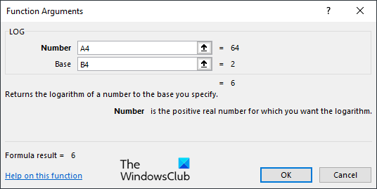

- Type into the cell where you want to place the result =LOG (A4, B4).
- Press Enter to see the result. The result is 6.

A Function Arguments dialog box will open.
Type into the entry boxes the cell that contains the number you want to calculate.
Then click OK.

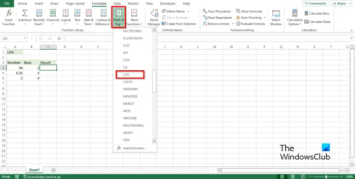

Method two is to click the Formulas tab and click the Math and Trigonometry button in the Function Library group.
Then select LOG from the drop-down menu.
Follow the same method in Method 1.
Then click OK.

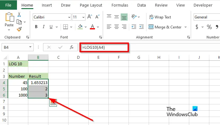

- Type into the cell where you want to place the result =LOG10(A4).
- Press Enter to see the result. The result is 1.653213.
- Now drag the fill handle down to see the other result.

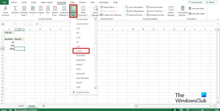

Then select LOG10 from the drop-down menu.
Then click OK.
