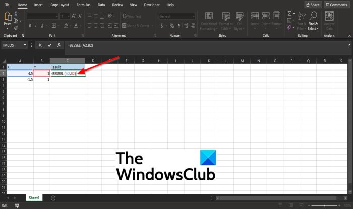

Type the formula into the cell you want to palace the result =BESSELI(A2, B2).

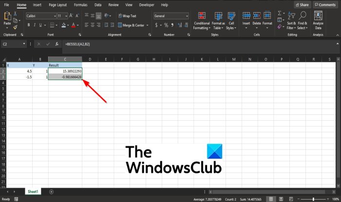

Then press the Enter Key.
If you have more than one data in the table, you can click the result and drag the fill handle down to see more results.

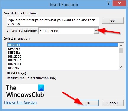

Method one is to click the fx button on the top left of the Excel worksheet.
An Insert Function dialog box will appear.
Inside the dialog box in the section, Select a Category, select Engineering from the list box.
In the section Select a Function, choose the BESSELI function from the list.
Then click OK.

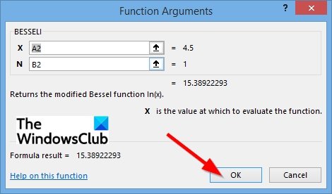

A Function Arguments dialog box will open.
In the X entry box, input into the entry box cell A2.
In the Y entry box, input into the entry box cell B2.

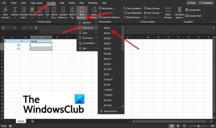

Method two is to click the Formulas tab, click the More function button in the Function Library group, hover the cursor or over Engineering, and select BESSELI from the drop-down menu.
A Function Arguments dialog box will appear.
