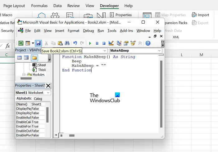

- Open Microsoft Excel and click on the Developer tab. If you don’t have the Developer option on your options ribbon, you can add it by clicking on File > Options > Customize Ribbon > select Developer
- You’ll then see a Visual Basic Option under the Developer tab. Clicking on it will open the VBA window separately
- Go to Insert > Module and paste the following block of code there
Function MakeABeep() as String Beep MakeABeep = “” End Function
- Click on the Save icon and in the subsequent dialog box, ensure that you save it as an Excel Macro-Enabled Workbook. Also, ensure that you maintain the indentation in this block of code
- Now, close the Microsoft Visual Basic for Applications window
You can then easily test if this alarm is working or not. In an empty cell, type =MakeABeep() and press enter.
