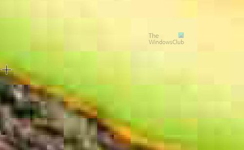

I observed some JPEG Artifacts especially around the edges, closer to the skin. can you see the boxy colors?

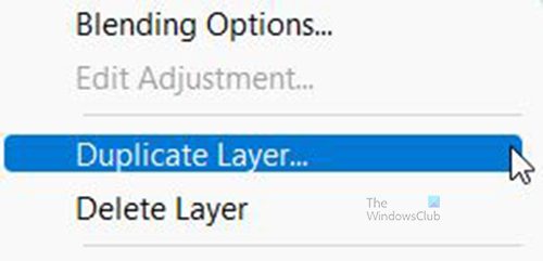

To duplicate the image, go to the Layers panel and right-click on the image then press Duplicate Layer. You can also duplicate the layer by clicking on the image and dragging it down to the Create a new layer icon at the bottom of the Layers panel. A new layer will be created, it will be a copy of the first layer so it will be named xx copy it will be above the previous layer. Another way to duplicate the layer is to press Ctrl + J.

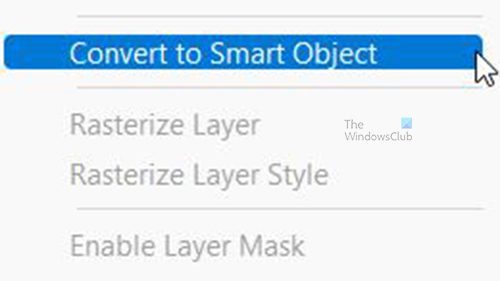

To begin using the filter, convert the top layer to a smart object by right-clicking on it and choosing “Convert to Smart Object”. Converting to a smart object will allow the noise reduction adjustment to apply as a smart filter. This way you can easily edit it later if you need to.

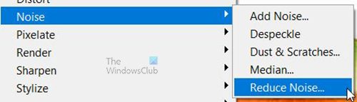

With the copy layer selected go to Filter then Noise then Reduce Noise. The Reduce Noise filter dialogue box will come up for you to make adjustments. Stay in the basic mode, which is the first mode that the Reduce Filter will be on. Note there will be no hard and fast rule in the value that will be needed for each. This means you will need to move the sliders slowly and observe the changes to your image. The image used in this article will have a different level of noise and JPEG artifact present in it.

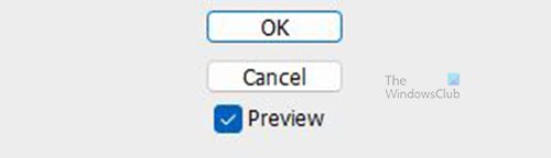

There is the Ok and the Cancel button so that you can confirm or cancel changes.
There is the Preview check box for you to check or uncheck if need or do not need a preview of the changes on the original image as you work. There are the options of Basic and Advance. The basic is the first set of controls that you see and the advance offers the option to change the Luminance on each channel (Red, Green, and blue) separately. The reduce noise dialogue box has a preview window so that you can see what is happening as you make changes. There is the Settings drop-down menu, you can save settings after you have made them and they will appear in the Settings drop-down menu. Just press the little box with the arrow, and a New Filter Setting dialogue will appear for you to name your new setting. The Strength and Preserve Details are used to remove Luminance noise. The Reduce Color Noise is used to reduce color noise in the image. Under the preview window you will see – and + buttons, you use these to zoom in and zoom out on the image that is previewed.

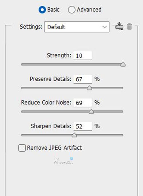

While still in the Reduce Filter dialogue, zoom the previewed image to 100% so that you can see the noise. The Reduce Noise filter will be in the Basic Mode.
These are the controls that are available in the Basic Mode.
Go to each of the sliders and adjusts them and watch the changes in the image.
Strength – This is used to reduce the Luminance noise in the image. Click in the Strength value box and use the Up or Down arrow on the keyboard and adjust the values, watch as the image changes. Stop changing the values when the image is satisfactory.
Preserve Details – The Preserve Details slider is used to bring back as many of the details of the image. The Strength slider would have removed some of the image’s original details so the Preserve details would help to bring back as many of the details as possible. Remember that it will not be possible to get a perfect image, however, try to make the image as realistic as possible.
Reduce Color Noise – This Slider removes color noise in the image. Use this slider if you notice color noise in your image.
Sharpen – Keep this slider low as sharpening the image may show up the noise again. Place it at zero then click in the value box and use the Up arrow on the keyboard to slowly adjust the value. Observe the image and stop adjusting it when it looks satisfactory.
Remove JPEG Artifacts – You may notice in your image that there are JPEG Artifacts. JPEG Artifacts are blocky distortions or halos in the image caused by saving with a low JPEG quality setting. Check the Remove JPEG Artifact option and see the blotches disappear.

To duplicate the image, go to the Layers panel and right-click on the image then press Duplicate Layer. You can also duplicate the layer by clicking on the image and dragging it down to the Create a new layer icon at the bottom of the Layers panel. A new layer will be created, it will be a copy of the first layer so it will be xx copy it will be above the previous layer. Another way to duplicate the layer is to press Ctrl + J.

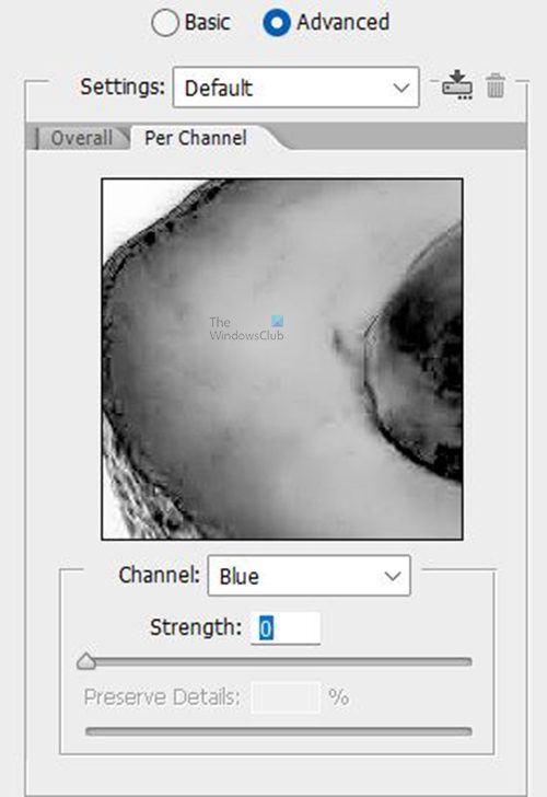

For this method, go over to the Advanced mode instead of staying on the Basic mode.
The advanced mode allows you to isolate each channel (red, green, and blue) and remove noise. You can scan the picture to see which channel has more noise and remove it. Oftentimes one channel will have more noise than the others.
Below the channel button, there are two sliders, Strength and Preserve Details. The Strength option allows you to remove noise, and the Preserve Details allows you to bring back the details that were lost during the noise removal process. The best way to control both Strength and Preserve Details is to place both at 0 value, click inside the value window, and use the keyboard’s up and down arrow to change the values. Move slowly and watch the changes in the images. Remember that you will have to observe the changes in the image and stop when the image looks satisfactory.
