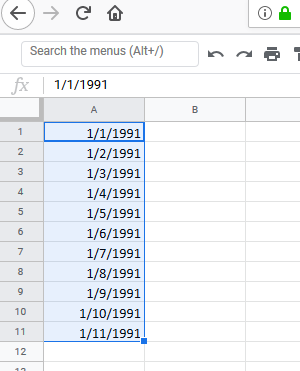

Simply Enter the date in say cell A1 and click anywhere outside the cell. Then click on the cell again to activate the Fill handle.
Pull the Fill handle down to create a list of sequential dates in Excel.

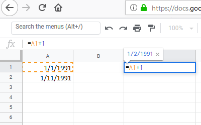

Suppose the starting date is in cell A1, and the ending date is in cell A2. You need to obtain the list in column C. The procedure for finding the list of dates would be as follows:
First, enter the formula and press Enter:
=A1+1 in cell C1
It will display the date next to the starting date in cell C1.
Now, type the following date in cell C2:
=IF($A$1+ROW(A1)>=$A$2-1,"",C1+1)
Click anywhere outside cell C2 and then back on C2 to highlight the option to pull the formula down. Pull the formula down till you start getting blank results on the cells. Hit Enter to display the results.
