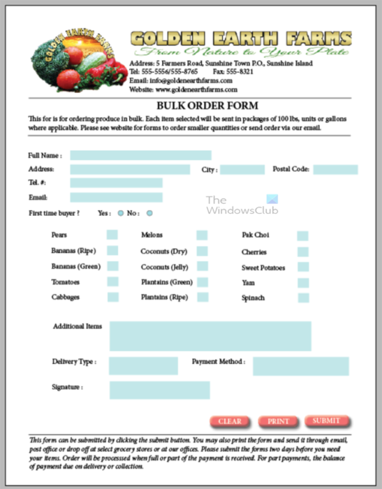

2] Layout your form in InDesign
When you have planned how you want your form to look, it is time to create it In InDesign.

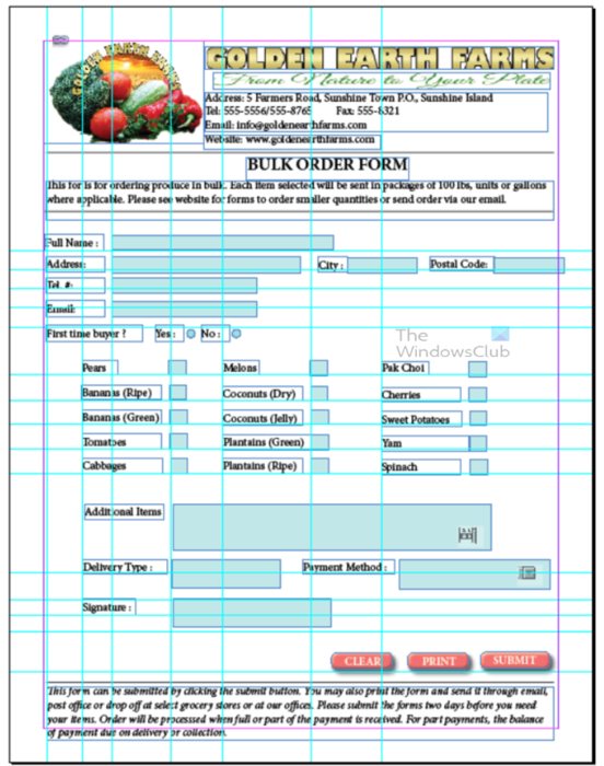

This is the form created in InDesign, you see the guides that were used to line up the elements properly.
This is the form with the guides and other lines hidden. To hide the guides, press W, to make them show again just press W.
You can create the form field by field and add interactivity as you go along. You can also create the whole form with the fields and then make them add interactivity after. In this case, the whole form was created then the

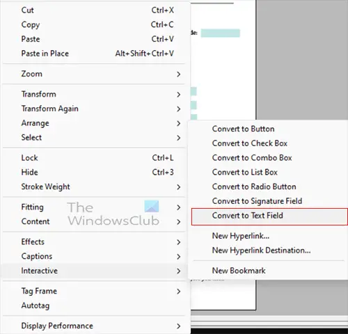

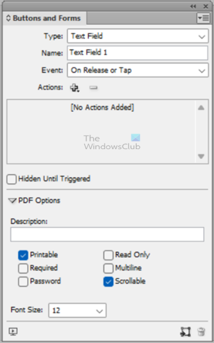

To make this field interactive, bring up the Buttons and Forms pallet by going to Window then Interactive then Buttons and Forms. The buttons and forms pallet will open.
An easy way to get to the button or form that you want for your field is to right-click on the field and click Interactive then Convert to text field.
The Buttons and Forms pallet will show up here you will select the options that you want for your button.
Name
Give the text field a unique name; this is important because you will need to know it for other steps. You can name this first text field CustomerName. Do not use special characters and do not leave space between if you use two words.
Event
This is where you want the button to do something when this happens. You can leave it on the default which is On release or tap.
Actions
This is what you want this field to do, but since this is a text field it will do nothing, so this is left as it is.
Description
Write a short description of what the field is for. This is very important as whatever you put here will show up when the user hovers over the field. Ensure that you fill Description correctly so that users will know what each field is for. Do not assume that the names beside them are enough.
Other settings
Select Printable so that the data in that field will print. Select Required so that the person will have to fill out that field or the form will not submit. Uncheck Scrollable because you want all the content to hold in a single line. For this field, uncheck Password, Read-only, and Multiline, these options may be required for other fields but for the Name field, they are not required. You will know what you want for your form, so choose what you want to fit your needs. Follow these steps for each of the text fields, modifying if you need other functions. An easy way is to change one field and then copy and paste it for all similar fields; you then change the name and the other options.

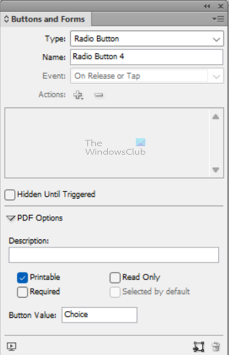

4] Add Radio buttons
The radio buttons are the circles that get a black dot in the middle when they are selected. These work in groups of two or more and only one can be selected at a time in a group. They are usually used for closed-ended questions such as yes or no.
Create the radio button

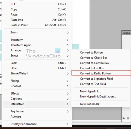

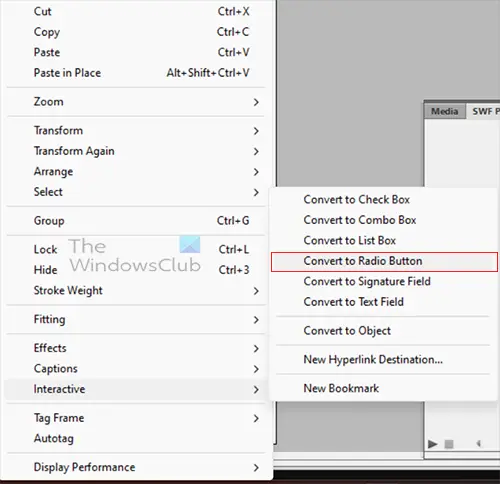

To create the radio buttons, write the questions the put Yes and No. You would then put a small circle after Yes and one after No. When they are created, hold Shift and select both circles.
You then right-click on both circles, select Interactive then Convert to Radio Buttons.
The buttons and Forms panel will appear. Give the radio buttons a descriptive name. Remember that if you have more sets of radio buttons in your form, you will need to identify them. Each set of radio buttons should have the same name so that they will be grouped. Since these radio buttons are for the question first-time buyer, you can name both FirstTimeBuyer. Since you selected both, they should automatically get the same name. You can then select each separately and give animation, such as what you want them to look like when the user rolls the mouse over the radio buttons.

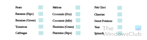

5] Add the Checkboxes

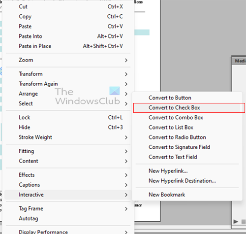

The checkboxes work almost like the radio buttons. However, check boxes allow the user to have more than one option selected. To create the checkboxes, write the words that you want then draw a little square beside it.
Add interactivity to checkboxes
With the checkboxes created, it is time to make them interactive, right click on the box, and from the menu select Interactive then Convert to check box.
The Buttons and Forms pallet will appear. Give the checkboxes descriptive names, these will be named based on the items beside each.
With the Buttons and Forms panel open you will just need to click on each, change the name and move to the next. You will not need to add any Actions.

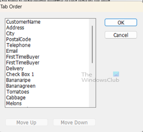

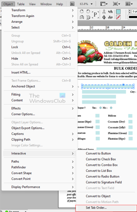

Setting the tab order is very important in forms. The Tab order is the order that the cursor will jump whenever the user presses the tab key in the form. Users usually press the tab key to move on to the next item in a form as they fill out the form. If the Tab order is not correct, it could lead to wrong results and frustration for users. If you created the form straight in order from top to bottom, then the tab order is usually straight as it should be. InDesign naturally follows the flow of how you created the form. However, for some reason, your Tab order may be thrown off.
Here is how you can check and correct your tab order. Go to the top menu bar and press Object then Interactive and then Set Tab Order.
The Tab Order window will show up and you will see the names of the form fields in the order that they will appear as the user presses the tab key. you will now realize the importance of the unique names of the different fields. Check through the list to see if they are all in order. You can also export the form as an Interactive PDF and press the Tab key and see if things are in order.
If you have items that are not in order in the Tab Order window you can just click it and press Move up or Move down. If you want to move multiple items at once, hold Ctrl then select each item. When they are all selected press Move up or Move down and they will all move together.

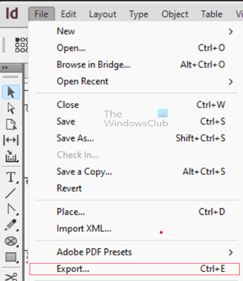

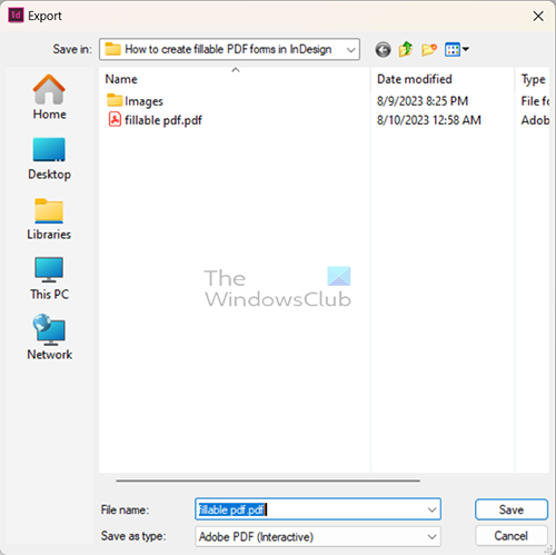

Now that the form is finished, the next step is to save it as an Interactive PDF.
To save the form as an Interactive PDF go to File then Export or press Ctrl + E.
The Export window will appear, give your file a name and then choose Save as type Adobe PDF (Interactive) then click Save.

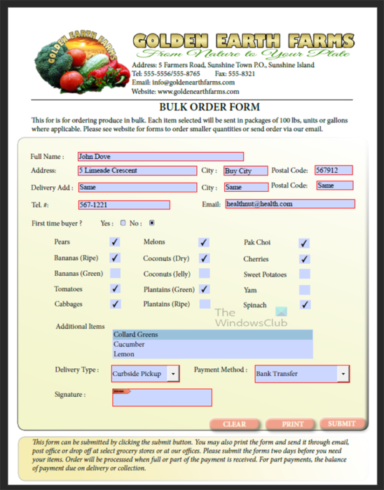

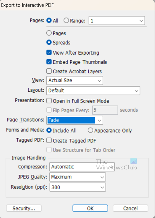

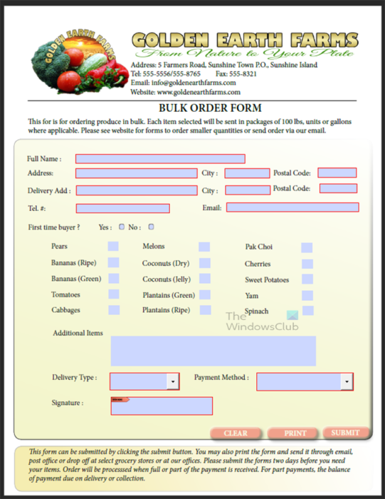

The Export to Interactive PDF options window will appear, here you will choose additional options for your interactive PDF. You can make the View Actual Size and the Resolution higher like 300. When you are finished press Ok to keep the options and close the window.
This is the Interactive PDF that you exported. You will notice some form fields with a red border; those are the required fields.

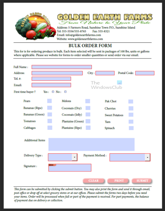

12] Additions and Styling
This is the step that will add or remove fields and make the form more attractive. When you save as an Interactive PDF and view the form, you may see where you need to add more fields to get more information. You may also notice that your form needs more things to make it more attractive. You can do these things and then save and re-export as an Interactive PDF. On this form, I realized that the customer’s address may be different from their delivery address, so it was added to the form. Some color was added to some areas using a rectangle and color added and the rectangle was placed at the back.
Add hyperlink
You can choose to make the website at the top of the form clickable by hyperlinking it. You would write the website as a separate text. You right-click the text or image to be hyperlinked, select Interactive, and then New Hyperlink. The New Hyperlink window will appear. Enter the web address that you want the link to go to.
Updated fillable PDF form.
Filling out the Interactive PDF
The user can easily fill out the Interactive PDF form and submit or print it. The form will also allow the user to save the form that is filled out and save, edit, or submit it later.
