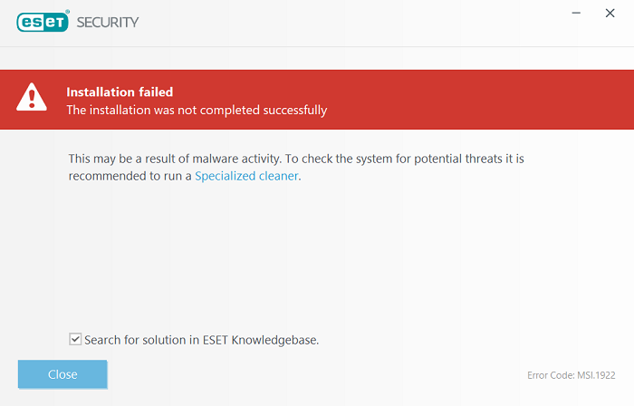

When using ESET products, if you face any issue with the installation, you can use the ESET Installation Fixer (InstaFix, install fix). It is a technical support tool for ESET products. ESET Installation Fixer is designed to fix several issues that can occur with services while installing ESET software.
ESET Installation failed

Depending on which one you downloaded, the file name can be ESETInstallationFixer_32.exe or ESETInstallationFixer_64.exe. You will also need admin permission, as some of the methods will remove the registry entries.
1] Installation Fixer
If you face issues with the installation of ESET software like incomplete installation or program, then run the below-mentioned option along with the Installation fixer on the command prompt.
ESETInstallationFixer_64.exe -fix MRL
